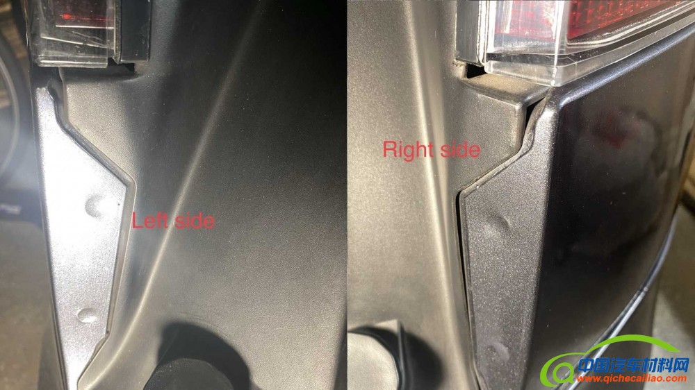

“My 15-year-old and I performed some extensive online research regarding this particular issue. We came across a forum thread where it was recommended to apply a lubricant to the rubber grommets, and gradually make fine adjustments until it closes on the plastic shim with its entire round face, contacting the lower plastic shim.
The left side of the liftgate comes into contact almost perfectly. However, it’s absolutely impossible for the right side rubber grommet to even have any contact with the plastic bottom shim.
As per the photo, the threading and surrounding area which holds the lower round plastic shim is significantly out of line. There are multiple signs of fracturing in the aluminum body. Additional signs of deformation failure are evident in the upper portions of this structure, contained to the right side.”
Tesla Model S Reveals Intriguing CPO Story Through Pressure Buffeting
That was when "Alec" started to suspect his car had a structural defect or failure.
“Just like the foundation of a building, when the lower portion of any structure is compromised, there must be further deficiencies above. The inconsistent gaps that are evident are directly correlated to this area where the compromised threaded rod is located. The out-of-level area results in the round plastic disc being out of line, which prevents the liftgate from sitting flush, level and having consistent reveals. I documented this concern in writing to Tesla. They reassured me the car wasn’t in any accidents and furnished me a CarFax reflecting such.”
