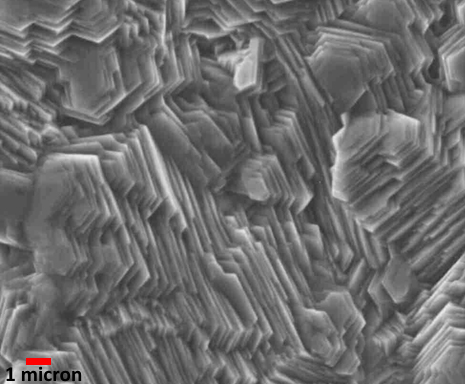

1-EG-Coating-Surface
Differences in the surface appearances of electrogalvanized (top) and galvannealed (bottom) steels, as shown here under magnification, contribute to differences in how they must be formed and painted.

The spangle of most hot-dip galvanized surfaces will show through paint. Although electrogalvanized and galvannealed surfaces both can be appropriate for exposed-quality applications, the surfaces hold lubricant differently and have different surface profiles as shown in the image. This leads to different forming conditions. Further, changes in zinc-coating composition will impact the welding parameters used, and the ability to paint the coated steel.
