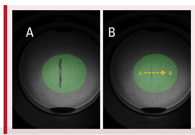

In the past, those conducting the test would try to sense necking of the specimen using their fingers. once they sensed necking, they would manually measure the strain distribution on that section. Now, noncontact optical DIC systems can sense the onset of necking and then measure strain distribution. The operator can set the DIC system to take photographs of the test specimen at given time increments (at least 10 photos/sec., according to ISO 12004-2008) from the time the punch starts to deform the sheet metal until after a crack forms (Fig. 2A).

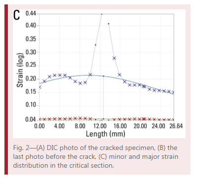

At test completion, the operator uses the last photo before fracture to calculate the strains at the most critical sections (Fig. 2B). A curve fit is applied to find the major and minor strains at the apex, and includes only the data points that have not already necked. Fig. 2C shows the major strain calculation of 1-mm-thick DP590, with minor strain shown in red. For the given geometry, major strain was calculated as 0.211 and minor as 0.051. This corresponds to point AB in Fig. 1.
