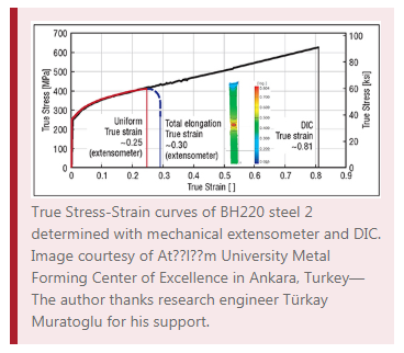

As an example, consider the results of an experimental study (see the accompanying figure, page 32) with a bake-hardenable steel, 220-MPa yield strength. Testing with a mechanical extensometer revealed a 28-percent uniform elongation (Ag) and 35-percent total elongation (A80). In true strain, these numbers correspond to 0.25 and 0.30, respectively, so a true stress-strain curve with the extensometer only gives valid data until 0.25 true strain (the red curve in the figure). Conversely, testing with DIC enabled measuring true strain until 0.81.
