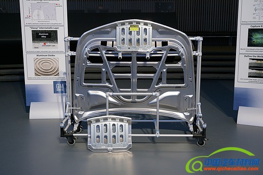

once the mixed-material welding of the CT6 seatback is up to speed, engineers are eying the car’s hood with the intention of welding the pedestrian-impact steel reinforcement to the hood's aluminum “inner.” This will eliminate scores of rivets currently used to join the two pieces, Carlson said.
